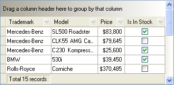

为了演示汇总值的格式设置,在下面的示例中,GridSummaryItem.DisplayFormat 属性被设置为 "Total {0} records"。
gridView1.OptionsView.ShowFooter = true; gridView1.Columns[0].SummaryItem.SummaryType = DevExpress.Data.SummaryItemType.Count; gridView1.Columns[0].SummaryItem.FieldName = "Trademark"; gridView1.Columns[0].SummaryItem.DisplayFormat = "Total {0} records"; | |
GridView1.OptionsView.ShowFooter = True GridView1.Columns(0).SummaryItem.SummaryType = DevExpress.Data.SummaryItemType.Count GridView1.Columns(0).SummaryItem.FieldName = "Trademark" GridView1.Columns(0).SummaryItem.DisplayFormat = "Total {0} records" | |
下面的屏幕截图展示了本示例的运行结果。
