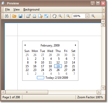

把 Windows.Forms 控件插入报表中 (运行时刻示例)
要把 Windows 窗体控件插入到报表中,首先要创建一个 WinControlContainer 对象,然后把之前创建的 Windows 窗体控件的引用,指派到 WinControlContainer.WinControl 属性。 然后,把所创建的 WinControlContainer 对象添加到 报表带区。 下面的代码举例说明了如何把一个 System.Windows.Forms.MonthCalendar 对象插入到报表中。
首先,在 XtraReport1 类中定义下述 AddWinControl 方法。
| C# |  复制代码 |
using System.Drawing; using DevExpress.XtraReports.UI; // ... public void AddWinControl(System.Windows.Forms.Control wrappedControl, Point location, Size controlSize){ // creating a WinControlContainer object WinControlContainer winControlContainer1 = new WinControlContainer(); // setting its location and size winControlContainer1.Location = location; winControlContainer1.Size = controlSize; // set a wrappedControl as a wrapped object winControlContainer1.WinControl = wrappedControl; // adding a WinControlContainer object to the Detail band of the report Detail.Controls.Add(winControlContainer1); }  | |
| Visual Basic |  复制代码 |
Imports System.Drawing Imports DevExpress.XtraReports.UI ' ... Public Sub AddWinControl(ByVal wrappedControl As System.Windows.Forms.Control, _ ByVal location As Point, ByVal controlSize As Size) ' creating a WinControlContainer object Dim winControlContainer1 As WinControlContainer = New WinControlContainer() ' setting its location and size winControlContainer1.Location = location winControlContainer1.Size = controlSize ' set a wrappedControl as a wrapped object winControlContainer1.WinControl = wrappedControl ' adding a WinControlContainer object to the Detail band of the report Detail.Controls.Add(winControlContainer1) End Sub  | |
然后创建一个 MonthCalendar 对象,并添加到所创建的报表中。
| C# |  复制代码 |
using System; using System.Drawing; using System.Windows.Forms; using DevExpress.XtraReports.UI; // ... // creating a MonthCalendar object and setting the new first day of the week MonthCalendar mnthCalendar = new MonthCalendar(); mnthCalendar.FirstDayOfWeek = Day.Monday; // creating a report XtraReport1 report = new XtraReport1(); // adding mnthCalendar to the Detail band of the report with the specified // Location and Size properties of a winControlContainer object report.AddWinControl(mnthCalendar, new Point(50, 20), new Size(200, 160)); // showing the report preview report.ShowPreview();  | |
Imports System Imports System.DrawingImports System.Windows.Forms Imports DevExpress.XtraReports.UI ' ... ' creating a MonthCalendar object and setting the new first day of the week Dim mnthCalendar As New MonthCalendar() mnthCalendar.FirstDayOfWeek = Day.Monday ' creating a report Dim report As New XtraReport1() ' adding mnthCalendar to the Detail band of the report with the specified ' Location and Size properties of a winControlContainer object report.addWinControl(mnthCalendar, New Point(50, 20), New Size(200, 160)) ' showing the report preview report.ShowPreview()  | |
在下面的插图中显示了结果。
