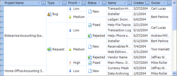

XtraGrid 3 推出了单元格合并功能,允许合并邻近的有相同取值的单元格。 这为用户提供了查看屏幕信息的可选择的方式。 下面的插图展示了启用单元格合并功能的网格视图。

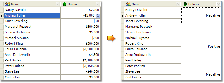

下面的示例代码接管了 GridView.CellMerge 事件,合并在 Balance 列中有相同符号的单元格。 接管了 GridView.CustomDrawCell 事件,为被合并单元格提供适当的显示文本。
using DevExpress.XtraGrid.Views.Grid using DevExpress.XtraGrid.Views.Base private void gridView1_CellMerge(object sender, CellMergeEventArgs e) { if(e.Column != gridView1.Columns["Balance"]) return; int value1 = Convert.ToInt32(gridView1.GetRowCellValue(e.RowHandle1, e.Column)); int value2 = Convert.ToInt32(gridView1.GetRowCellValue(e.RowHandle2, e.Column)); if(Math.Sign(value1) == Math.Sign(value2)) { e.Merge = true; e.Handled = true; } } private void gridView1_CustomDrawCell(object sender, RowCellCustomDrawEventArgs e) { if(e.Column != gridView1.Columns["Balance"]) return; switch(Math.Sign(Convert.ToInt32(e.CellValue))) { case -1: e.DisplayText = "Negative"; break; case 0: e.DisplayText = "Zero"; break; case 1: e.DisplayText = "Positive"; break; default: break; } } | |
Imports DevExpress.XtraGrid.Views.Grid Imports DevExpress.XtraGrid.Views.Base Private Sub GridView1_CellMerge(ByVal sender As Object, ByVal e As CellMergeEventArgs) _ Handles GridView1.CellMerge If Not e.Column Is GridView1.Columns("Balance") Then Exit Sub End If Dim value1 As Integer = Convert.ToInt32(GridView1.GetRowCellValue(e.RowHandle1, e.Column)) Dim value2 As Integer = Convert.ToInt32(GridView1.GetRowCellValue(e.RowHandle2, e.Column)) If Math.Sign(value1) = Math.Sign(value2) Then e.Merge = True e.Handled = True End If End Sub Private Sub GridView1_CustomDrawCell(ByVal sender As Object, _ ByVal e As RowCellCustomDrawEventArgs) _ Handles GridView1.CustomDrawCell If Not GridView1.OptionsView.AllowCellMerge Then Exit Sub End If If Not e.Column Is GridView1.Columns("Balance") Then Return End If Select Case Math.Sign(Convert.ToInt32(e.CellValue)) Case -1 e.DisplayText = "Negative" Case 0 e.DisplayText = "Zero" Case 1 e.DisplayText = "Positive" Case Else End Select End Sub | |
下面的插图展示了运行结果。
