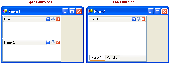

下列代码演示了如何通过把一个面板停靠到其他面板来创建分隔式容器,然后把这个分隔式容器转换为标签式容器。
using DevExpress.XtraBars.Docking; // ... // Create a panel and dock it to the form's right edge. DockPanel panel1 = dockManager1.AddPanel(DockingStyle.Right); panel1.Text = "Panel 1"; // Add a new panel to panel1. This forms a split container that owns panel1 and panel2. DockPanel panel2 = panel1.AddPanel(); panel2.Text = "Panel 2"; // Transform the split container into a tab container. DockPanel container = panel1.ParentPanel; container.Tabbed = true; | |
Imports DevExpress.XtraBars.Docking ' ... ' Create a panel and dock it to the form's right edge. Dim panel1 As DockPanel = dockManager1.AddPanel(DockingStyle.Right) panel1.Text = "Panel 1" ' Add a new panel to panel1. This forms a split container that owns panel1 and panel2. Dim panel2 As DockPanel = panel1.AddPanel() panel2.Text = "Panel 2" ' Transform the split container into a tab container. Dim container As DockPanel = panel1.ParentPanel container.Tabbed = True | |
在上述代码中,所创建的容器是通过 panel1 的 DockPanel.ParentPanel 属性进行访问的。 panel2.ParentPanel 将给出相同的结果,因为 panel1 和 panel2 都属于相同的容器。
代码的执行结果显示在下面:
注意,当容器仅包含一个面板时,容器会被自动销毁,例如一个容器只包含了两个面板并且其中一个面板被取消停靠。 在这种情况下,当容器被销毁之后,容器的子面板的 DockPanel.ParentPanel 属性将立即返回 null。

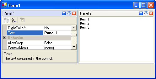

示例 3
在下面的示例中,创建了一个分隔式容器,它由两个停靠面板构成。 一个 PropertyGrid 控件被放置在第一个面板中,一个 ListBox 控件被放置在第二个面板中。
// Create dock panels, panel1 and panel2 form a split container. DockPanel panel1 = dockManager1.AddPanel(DockingStyle.Top); panel1.Text = "Panel 1"; DockPanel panel2 = panel1.AddPanel(); panel2.Text = "Panel 2"; // Place a PropertyGrid control on panel1. PropertyGrid pGrid = new PropertyGrid(); pGrid.SelectedObject = panel1; pGrid.Dock = DockStyle.Fill; panel1.ControlContainer.Controls.Add(pGrid); // Place a ListBox control on panel2. ListBox lBox = new ListBox(); lBox.Items.AddRange(new string [] {"Item 1", "Item 2", "Item 3"}); lBox.Dock = DockStyle.Fill; panel2.ControlContainer.Controls.Add(lBox); | |
' Create dock panels, panel1 and panel2 form a split container. Dim panel1 As DockPanel = dockManager1.AddPanel(DockingStyle.Top) panel1.Text = "Panel 1" Dim panel2 As DockPanel = panel1.AddPanel() panel2.Text = "Panel 2" ' Place a PropertyGrid control on panel1. Dim pGrid As PropertyGrid = New PropertyGrid pGrid.SelectedObject = panel1 pGrid.Dock = DockStyle.Fill panel1.ControlContainer.Controls.Add(pGrid) ' Place a ListBox control on panel2. Dim lBox As ListBox = New ListBox lBox.Items.AddRange(New String() {"Item 1", "Item 2", "Item 3"}) lBox.Dock = DockStyle.Fill panel2.ControlContainer.Controls.Add(lBox) | |
考虑性能因素,因此不要把可视化控件添加到停靠面板的 Controls 集合中。 而是直接把这些控件添加到 DockPanel.ControlContainer 对象的 Controls 集合中。
