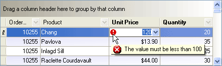

如果 Valid 参数被设置为 false,则网格控件将在单元格内显示一个错误图标 (
)。 当鼠标指针停留在错误图标上时,显示一个说明提示 (“Invalid Value”)。 要提供自定义错误说明,则把所需的字符串指派到此事件的 ErrorText 参数。

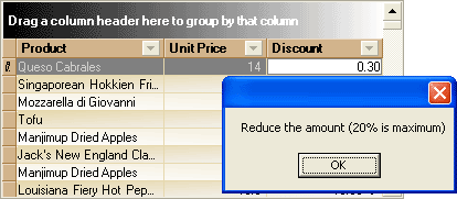

下列代码展示了如何接管 BaseView.ValidatingEditor 事件,来为 Discount 列限制最终用户的输入。 该列仅接受介于 0 和 0.20 之间的取值。 其他取值被视为无效。 BaseView.InvalidValueException 事件被接管,来显示一个有自定义错误消息的消息框:
using DevExpress.XtraGrid.Views.Grid; using DevExpress.XtraEditors.Controls; private void gridView1_ValidatingEditor(object sender, BaseContainerValidateEditorEventArgs e) { GridView view = sender as GridView; if(view.FocusedColumn.FieldName == "Discount") { //Get the currently edited value double discount = Convert.ToDouble(e.Value); //Specify validation criteria if(discount < 0) { e.Valid = false; e.ErrorText = "Enter a positive value"; } if(discount > 0.2) { e.Valid = false; e.ErrorText = "Reduce the amount (20% is maximum)"; } } } private void gridView1_InvalidValueException(object sender, InvalidValueExceptionEventArgs e) { //Do not perform any default action e.ExceptionMode = DevExpress.XtraEditors.Controls.ExceptionMode.NoAction; //Show the message with the error text specified MessageBox.Show(e.ErrorText); } | |
Imports DevExpress.XtraGrid.Views.Grid Imports DevExpress.XtraEditors.Controls Private Sub GridView1_ValidatingEditor(ByVal sender As Object, _ ByVal e As BaseContainerValidateEditorEventArgs) Handles GridView1.ValidatingEditor Dim View As GridView = sender If View.FocusedColumn.FieldName = "Discount" Then 'Get the currently edited value Dim discount As Double = Convert.ToDouble(e.Value) 'Specify validation criteria If discount < 0 Then e.Valid = False e.ErrorText = "Enter a positive value" End If If discount > 0.2 Then e.Valid = False e.ErrorText = "Reduce the amount (20% is maximum)" End If End If End Sub Private Sub GridView1_InvalidValueException(ByVal sender As Object, _ ByVal e As InvalidValueExceptionEventArgs) _ Handles GridView1.InvalidValueException 'Do not perform any default action e.ExceptionMode = DevExpress.XtraEditors.Controls.ExceptionMode.NoAction 'Show the message with the error text specified MessageBox.Show(e.ErrorText) End Sub | |
