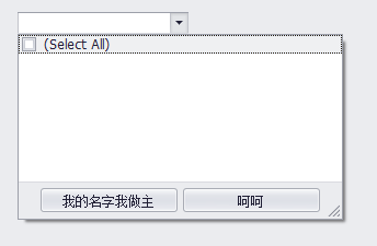

关于DevExpress很多下拉框的按钮自定义显示文本问题,默认是OK 和Cancel,
想修改按钮的显示文本,除了汉化还有一种就是直接修改属性,隐藏有点深(该方法只有16.2有,以下的的不支持);
(评分可查看代码)
效果图:

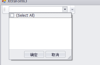

发表于 2017-11-22 17:44:05 | 显示全部楼层
15.2.4的解决方案 CheckedPopupContainerForm类从版本10.1开始实现。对于较早的版本使用PopupContainerForm类。
        private void chkCmbDataModelList_Popup(object sender, EventArgs e)
            CheckedPopupContainerForm chkPopFrm = (sender as IPopupControl).PopupWindow as CheckedPopupContainerForm;
            PopupContainerControl popupControl = null;
            foreach (Control ctrl in chkPopFrm.Controls)
                if (ctrl is SimpleButton)
                    SimpleButton btn = ctrl as SimpleButton;
                    if (btn.Text == "OK")
                        btn.Text = "确定";
                    else if (btn.Text == "Cancel")
                        btn.Text = "取消";
