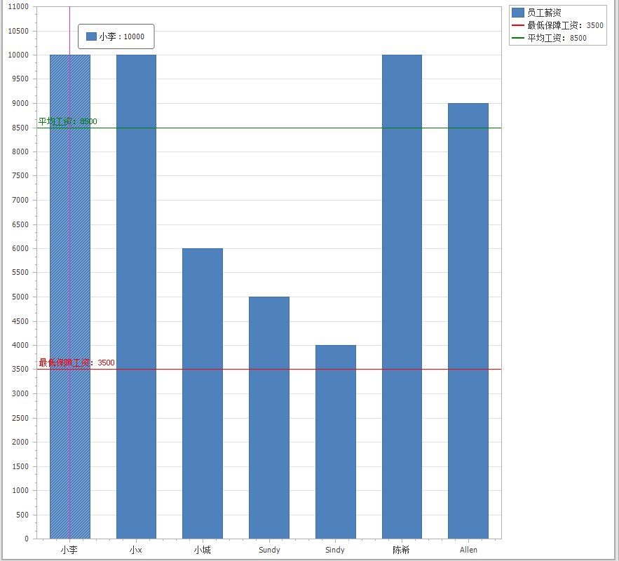

关于DevExpress ChartControl 如何显示垂直X轴和垂直Y轴直线设置,
例如下图所示。
代码如下:(评分后可以查看)

同样效果的wpf代码
<dxc:ChartControl>
            <dxc:ChartControl.Legend>
                <dxc:Legend HorizontalPosition="Center" VerticalPosition="BottomOutside" ReverseItems="False" Orientation="Horizontal" >
                </dxc:Legend>
            </dxc:ChartControl.Legend>
            <dxc:ChartControl.Titles>
                <dxc:Title Content="Cartesian Chart" HorizontalAlignment="Center"/>
            </dxc:ChartControl.Titles>
            <dxc:XYDiagram2D Rotated="False" PaneOrientation="Horizontal">
                <dxc:XYDiagram2D.AxisY>
                    <dxc:AxisY2D>
                        <dxc:AxisY2D.ConstantLinesInFront>
                            <dxc:ConstantLine Brush="#CFFF002F" LegendText="最低保障工资">
                                <dxc:ConstantLine.Title>
                                    <dxc:ConstantLineTitle  Content="最低保障工资"/>
                                </dxc:ConstantLine.Title>
                                <dxc:ConstantLine.Value>
                                    <System:Object>3500</System:Object>
                                </dxc:ConstantLine.Value>
                            </dxc:ConstantLine>
                            <dxc:ConstantLine Brush="#CF00FF6E" Visible="True" LegendText="平均工资">
                                    <dxc:ConstantLineTitle Content="平均工资"/>
                                    <System:Object>8500</System:Object>
                            </dxc:ConstantLine>
                        </dxc:AxisY2D.ConstantLinesInFront>
                    </dxc:AxisY2D>
                </dxc:XYDiagram2D.AxisY>
                <dxc:BarSideBySideSeries2D DisplayName="员工工资" Brush="#FF4F81BD" LabelsVisibility="True">
                    <dxc:BarSideBySideSeries2D.Label>
                        <dxc:SeriesLabel dxc:BarSideBySideSeries2D.LabelPosition="Center"/>
                    </dxc:BarSideBySideSeries2D.Label>
                    <dxc:SeriesPoint Argument="A" Value="10000"/>
                    <dxc:SeriesPoint Argument="B" Value="10000"/>
                    <dxc:SeriesPoint Argument="C" Value="6000"/>
                    <dxc:SeriesPoint Argument="D" Value="5000"/>
                    <dxc:SeriesPoint Argument="E" Value="4000"/>
                    <dxc:SeriesPoint Argument="F" Value="10000"/>
                    <dxc:SeriesPoint Argument="G" Value="9000"/>
                </dxc:BarSideBySideSeries2D>
            </dxc:XYDiagram2D>
        </dxc:ChartControl>
