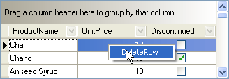

下面的示例演示了如何实现网格行的弹出式菜单。 此菜单只有一个菜单项,此菜单项用于删除调用菜单的行。 调用 GridView.CalcHitInfo 方法来获取行句柄。 然后把焦点移到此行,并调用自定义上下文菜单。
using DevExpress.XtraGrid.Views.Grid; using DevExpress.XtraGrid.Views.Grid.ViewInfo; using DevExpress.XtraGrid.Views.Base; using DevExpress.XtraGrid.Menu; using DevExpress.Utils.Menu; private void gridView1_MouseDown(object sender, MouseEventArgs e) { GridView view = sender as GridView; if(view == null) return; // obtaining hit info GridHitInfo hitInfo = view.CalcHitInfo(new Point(e.X, e.Y)); if (((e.Button & MouseButtons.Right) != 0) && (hitInfo.InRow) && (!view.IsGroupRow(hitInfo.RowHandle))) { // switching focus view.FocusedRowHandle = hitInfo.RowHandle; // showing the custom context menu ViewMenu menu = new ViewMenu(view); DXMenuItem menuItem = new DXMenuItem("DeleteRow", new EventHandler(DeleteFocusedRow)); menuItem.Tag = view; menu.Items.Add(menuItem); menu.Show(hitInfo.HitPoint); } } void DeleteFocusedRow(object sender, EventArgs e) { DXMenuItem menuItem = sender as DXMenuItem; if(menuItem == null) return; ColumnView View = menuItem.Tag as ColumnView; View.DeleteRow(view.FocusedRowHandle); } | |
Imports DevExpress.XtraGrid.Views.Grid; Imports DevExpress.XtraGrid.Views.Grid.ViewInfo; Imports DevExpress.XtraGrid.Views.Base; Imports DevExpress.XtraGrid.Menu; Imports DevExpress.Utils.Menu; Private Sub gridView1_MouseDown(ByVal sender As Object, ByVal e As MouseEventArgs) _ Handles gridView1.MouseDown Dim View As GridView = CType(sender, GridView) If View Is Nothing Then Return ' obtaining hit info Dim hitInfo As GridHitInfo = View.CalcHitInfo(New Point(e.X, e.Y)) If ((e.Button & MouseButtons.Right) <> 0) And (hitInfo.InRow) And _ (Not View.IsGroupRow(hitInfo.RowHandle)) Then ' switching focus View.FocusedRowHandle = hitInfo.RowHandle ' showing the custom context menu Dim menu As ViewMenu = New ViewMenu(view) Dim menuItem As DXMenuItem = New DXMenuItem("DeleteRow", _ New EventHandler(AddressOf DeleteFocusedRow)) menuItem.Tag = view menu.Items.Add(menuItem) menu.Show(hitInfo.HitPoint) End If End Sub Private Sub DeleteFocusedRow(ByVal sender As Object, ByVal e As EventArgs) Dim menuItem As DXMenuItem = CType(sender, DXMenuItem) If menuItem Is Nothing Then Return Dim View As ColumnView = CType(menuItem.Tag, ColumnView) View.DeleteRow(view.FocusedRowHandle) End Sub | |
下面的屏幕截图展示了上述代码的执行结果:
