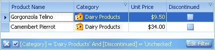

下列代码应用了一个筛选,选中在 Category 列中包含取值 3 并且在 Discontinued 列中包含 false 的记录。| C# | 复制代码 |
gridView1.ActiveFilterString = "[Category] = 3 AND [Discontinued] = false";
GridView1.ActiveFilterString = "[Category] = 3 AND [Discontinued] = false"

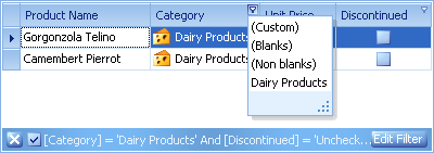

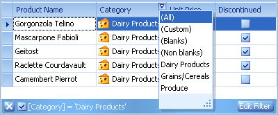

如果显示如下:
在本例中,Category 列使用了 ImageComboBoxEdit 内置编辑器,来把下层整数值呈现为附有图像的字符串。 例如,取值 3 通过“Dairy Products”字符串呈现。 在默认情况下,该列必须与编辑值比较。 因此,为了选择包含“Dairy Products”字符串的记录,使用了“Category = 3”筛选。
如果需要创建使用 Category 列显示值的筛选表达式,则把该列的 GridColumn.FilterMode 属性设置为 ColumnFilterMode.DisplayText。 下列代码与上述代码有相同的运行结果:
gridView1.Columns["Category"].FilterMode = DevExpress.XtraGrid.ColumnFilterMode.DisplayText; gridView1.ActiveFilterString = "[Category] = 'Dairy Products' AND [Discontinued] = false"; | |
GridView1.Columns["Category"].FilterMode = DevExpress.XtraGrid.ColumnFilterMode.DisplayText GridView1.ActiveFilterString = "[Category] = 'Dairy Products' AND [Discontinued] = false" | |

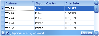

object val = "Poland"; GridColumn columnCountry = gridView1.Columns["ShipCountry"]; GridColumn columnCustomer = gridView1.Columns["CustomerID"]; columnCustomer.FilterInfo = new ColumnFilterInfo(columnCountry, val); | |
Dim val As Object = "Poland" Dim columnCountry As GridColumn= GridView1.Columns("ShipCountry") Dim columnCustomer As GridColumn= GridView1.Columns("CustomerID") columnCustomer.FilterInfo = New ColumnFilterInfo(columnCountry, val) | |
也可以通过构建一个执行这种筛选的表达式,根据单个取值来筛选列。 使用 ColumnFilterInfo 的有 string filterString 参数的构造函数。 下列代码与上面的代码等效:
GridColumn columnCustomer = gridView1.Columns["CustomerID"]; columnCustomer.FilterInfo = new ColumnFilterInfo("[ShipCountry] = 'Poland'"); | |

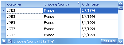

下列代码选择海运国 (ShipCountry) 名称以“F”起始的记录:
gridView1.Columns["ShipCountry"].FilterInfo = new ColumnFilterInfo("[ShipCountry] LIKE 'F%'"); | |
GridView1.Columns("ShipCountry").FilterInfo = New ColumnFilterInfo("[ShipCountry] LIKE 'F%'") | |

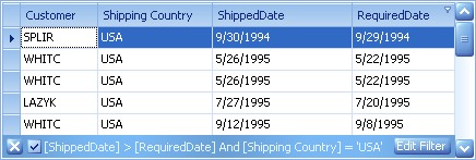

gridView1.Columns["RequiredDate"].FilterInfo = new ColumnFilterInfo( "[ShippedDate] > [RequiredDate] AND [ShipCountry] = 'USA'"); | |
GridView1.Columns("RequiredDate").FilterInfo = New ColumnFilterInfo( _ "[ShippedDate] > [RequiredDate] AND [ShipCountry] = 'USA'") | |
在本例中,筛选包含了 ShippedDate、RequiredDate 和 ShipCountry 字段的条件。 此筛选被指派到 RequiredDate 列的 GridColumn.FilterInfo 属性。 那也正是该列的筛选按钮被绘制为“活动”状态的原因。
