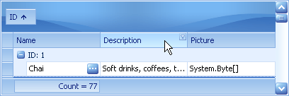

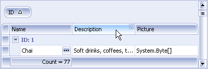

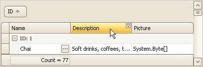

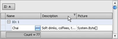

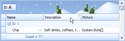

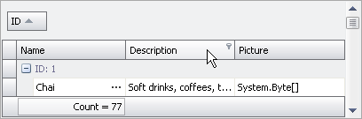

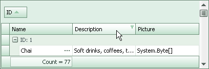

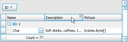

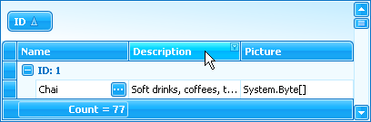

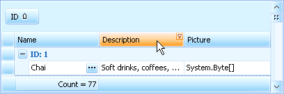

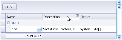

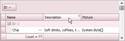

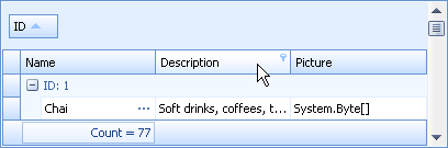

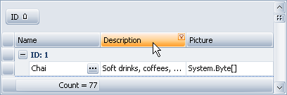

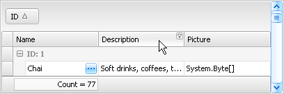

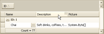

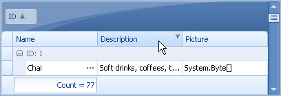

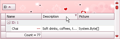

下表演示了一个使用可用皮肤绘制的网格控件:| 皮肤 | 库 | 插图 (XtraGrid 控件) |
| Caramel | DevExpress.Utils | ![]() |
| Money Twins | DevExpress.Utils | ![]() |
| Lilian | DevExpress.Utils | ![]() |
| The Asphalt World | DevExpress.Utils | ![]() |
| iMaginary | DevExpress.Utils | ![]() |
| Black | DevExpress.Utils | ![]() |
| Blue | DevExpress.Utils | ![]() |
