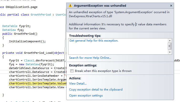

                chartControl1.DataSource = fyq;
                chartControl1.SeriesDataMember = "作物发育期";
                chartControl1.SeriesTemplate.ArgumentDataMember = "日期";
                chartControl1.SeriesTemplate.ValueDataMembers.AddRange(new string[] { "年份" });
                chartControl1.SeriesTemplate.View = new StackedBarSeriesView();
标注那行错误提示:An unhandled exception of type 'System.ArgumentException' occurred in DevExpress.XtraCharts.v15.1.dll
Additional information: It's necessary to specify 2 value data members for the current series view.
求高人指点!!

终于改好了,原来chartControl1.SeriesTemplate.ValueDataMembers.AddRange一行应该写成
                chartControl1.SeriesTemplate.ValueDataMembers.AddRange(new string[] { "年份","年份" });
