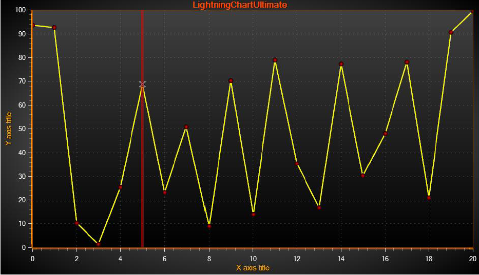

AxisGridStrips = None.

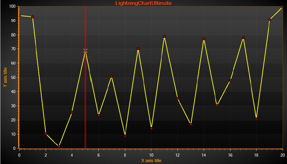

AxisGridStrips =X.

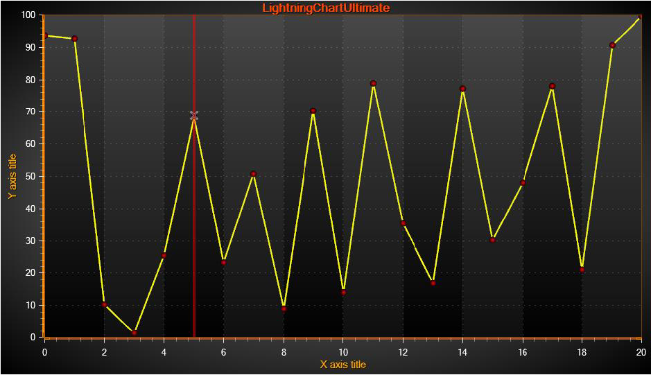

AxisGridStrips = Y.

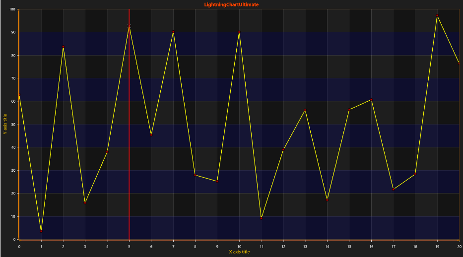

AxisGridStrips = Both. GridStripColor 同样在Y轴上也发生了变化
