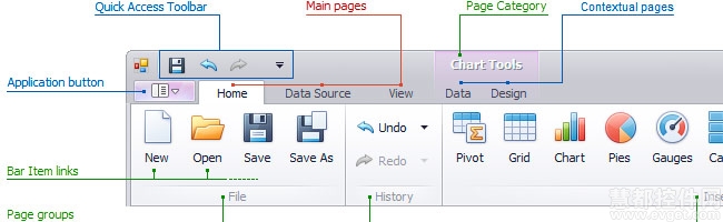

Ribbon上包含以下一些元素
F:/data/YNote/xtjatswc@163.com/xtjatswc@163.com/a62ccc92d7ca48bcb08a41e118b5db10/rd-ribbonui.jpeg
元素对应API:
Element
Ribbon API
Quick Access Toolbar
RibbonControl.Toolbar
RibbonQuickAccessToolbar.ItemLinks
Application Button
RibbonControl.ShowApplicationButton
RibbonControl.ApplicationButtonDropDownControl
Main pages
RibbonControl.Pages
Page Category
RibbonControl.Categories
Contextual pages
RibbonPageCategory.Pages
Page Groups
RibbonPage.Groups
RibbonPageGroup.ItemLinks
Bar Item links
RibbonControl.Items
BarItemLink.Item
