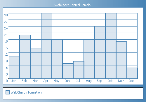

我用过的最简单的C# WebChart控件,特别适合在嵌入式系统下使用。是在一个国外网站上见到的。感觉好的给个评分,谢谢。
<%@ Page Language="C#" %>
<%@ Register tagPrefix="Web" Namespace="WebChart" Assembly="WebChart" %>
<%@ Import Namespace="System.Drawing" %>
<script runat=server>
      private void Page_Load(object sender, System.EventArgs e) {
            ColumnChart chart = new ColumnChart();
            chart.Fill.Color = Color.FromArgb(50, Color.SteelBlue);
            chart.Line.Color = Color.SteelBlue;
            chart.Line.Width = 2;
            chart.Legend = "WebChart information";
            chart.Data.Add( new ChartPoint("Jan", 10) );
            chart.Data.Add( new ChartPoint("Feb", 20) );
            chart.Data.Add( new ChartPoint("Mar", 14) );
            chart.Data.Add( new ChartPoint("Apr", 30) );
            chart.Data.Add( new ChartPoint("May", 18) );
            chart.Data.Add( new ChartPoint("Jun", 7) );
            chart.Data.Add( new ChartPoint("Jul", 8) );
            chart.Data.Add( new ChartPoint("Aug", 18) );
            chart.Data.Add( new ChartPoint("Sep", 24) );
            chart.Data.Add( new ChartPoint("Oct", 30) );
            chart.Data.Add( new ChartPoint("Nov", 17) );
            chart.Data.Add( new ChartPoint("Dec", 5) );
            ConfigureColors();
            ChartControl1.Charts.Add(chart);
            ChartControl1.RedrawChart();
    // Configure some colors for the Chart, this could be done declaratively also
      private void ConfigureColors() {
            ChartControl1.Background.Color = Color.FromArgb(75, Color.SteelBlue);
            ChartControl1.Background.Type = InteriorType.LinearGradient;
            ChartControl1.Background.ForeColor = Color.SteelBlue;
            ChartControl1.Background.EndPoint = new Point(500, 350) ;
            ChartControl1.Legend.Position = LegendPosition.Bottom;
            ChartControl1.Legend.Width = 40;
            ChartControl1.YAxisFont.ForeColor = Color.SteelBlue;
            ChartControl1.XAxisFont.ForeColor = Color.SteelBlue;
            ChartControl1.ChartTitle.Text = "WebChart Control Sample";
            ChartControl1.ChartTitle.ForeColor = Color.White;
            ChartControl1.Border.Color = Color.SteelBlue;
            ChartControl1.BorderStyle = BorderStyle.Ridge;
</script>
<html>
<head><title>WebChart Sample</title></head>
<body>
      <Web:ChartControl Width="500" Height="350" id="ChartControl1" runat="Server" />
</body>
</html>

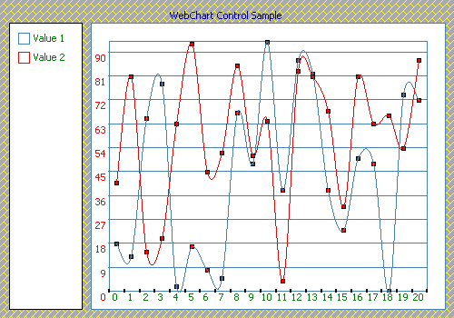

发表于 2016-12-7 16:47:11 | 显示全部楼层
文档好像打不开,请问设置成图二要什么属性?
