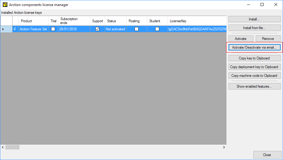

在无网络连接的情况下,可以采用邮件的方式激活授权。
1.       先打开License Manager,然后选 Activate/Deactivatevia email, 如下图所示:
via email
via email
  此邮件将自动发送到 licensing@arction.com

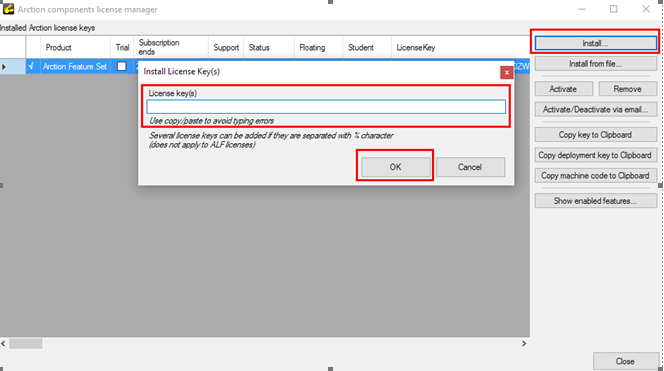

      2.  您将收到Arction邮件,内容如下:
input the license key
License key code:
[Paste customer’s key code here that you made with “Copy license code toCB” button]
If it asks “License with same IDalready exists, Overwrite?”. Select Yes.
