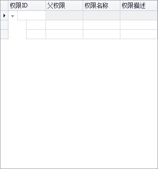

求助 treeList1 绑定数据源后 数据怎么不显示
127
2014-2-25
发表于 2014-4-9 14:55:50 | 显示全部楼层 |阅读模式
private void CreatTreeList()
            TreeListColumn tc1 = new TreeListColumn();
            tc1.Caption = "权限ID";
            tc1.VisibleIndex = 0;
            TreeListColumn tc2 = new TreeListColumn();
            tc2.Caption = "父权限";
            tc2.VisibleIndex = 1;
            TreeListColumn tc3 = new TreeListColumn();
            tc3.Caption = "权限名称";
            tc3.VisibleIndex = 2;
            TreeListColumn tc4 = new TreeListColumn();
            tc4.Caption = "权限描述";
            tc4.VisibleIndex = 3;
            this.treeList1.Columns.AddRange(new TreeListColumn[] { tc1, tc2, tc3, tc4, });
            DataSet mydata = AuthorityInfo.GetAllTabel("Tb_PerRigth");
            treeList1.Nodes.Clear();
            DataTable table = mydata.Tables[0];
            this.treeList1.DataSource = table;
            this.treeList1.KeyFieldName = "tt_id";
            this.treeList1.RefreshDataSource();
        } [img]file:///C:\Users\Administrator\AppData\Roaming\Tencent\Users\617204565\QQ\WinTemp\RichOle\S9[PPWXA`KHJS_SO_Q%O}}4.jpg[/img]

发表于 2016-10-23 12:19:22 | 显示全部楼层
应该还有parentid的p绑定

发表于 2016-11-20 00:17:11 | 显示全部楼层
TreeListColumn 没有设置FiledName,把数据源的字段名对应设置
